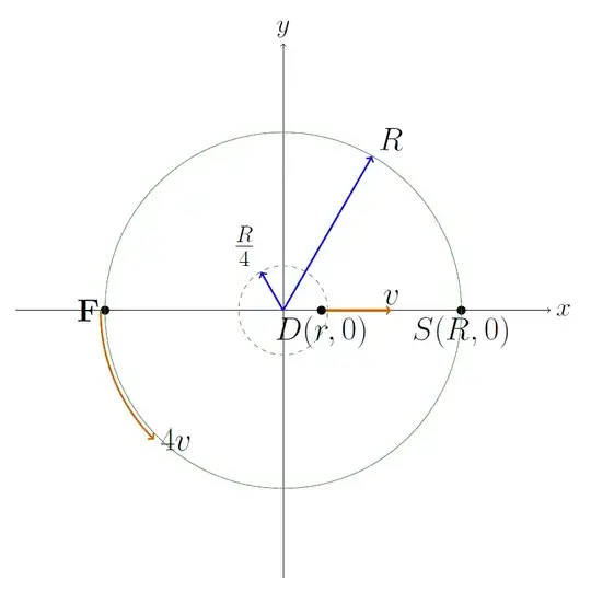

Let $R$ be the radius of the pond. Let the velocities be $v$ for the duck, and $4v$ for the fox (see diagram).
Phase 1 - The Headstart
As long as the duck stays with a circle of radius $\frac{R}{4}$, he can ensure that he keeps the fox as far away as possible (on a diametral line to himself) by turning in a spiral, where his maximum outward velocity is given by:
$\dot{r} = v\sqrt{1 - \dfrac{16r^2}{R^2}}$
Phase 2 - The Escape
Assume now that the duck has reached the point $D$ (as shown) at a radius $r$ from the center (with the fox at point $F$), and wants to begin phase 2. His fastest route to shore takes him to point $S$ and covers a distance of $R-r$, while the fox must cover arc length $R\pi$ to reach $S$. Hence, for the two times:
$t_D = \dfrac{R-r}{v}$ for the duck, and $t_F = \dfrac{R\pi}{4v}$ for the fox.
If the duck is to make safety we need
$\dfrac{R-r}{v} < \dfrac{R\pi}{4v}$ or $r > (1 - \dfrac{\pi}{4}) R \approx 0.2146 R$. Since this is within the spiral zone $(r < \dfrac{R}{4})$,
the duck will be able to safely reach the shore.
