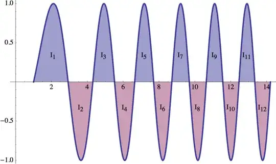

Let's take a look at a graph.
It appears that the graph oscillates up and down over the $x$-axis and that the labeled areas are decreasing to zero from left to right. In fact, it's not hard to prove these statements, namely
$$\int_1^\infty \sin(x\log x)\,dx = \sum_{n=1}^{\infty} (-1)^{n+1} I_n$$

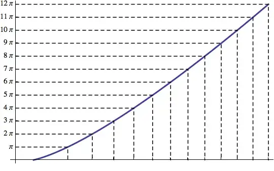

and that $\lim_{n\rightarrow\infty} I_n = 0$ with $0<I_{n+1}<I_n$. This boils down to the fact the area $I_k$ is bound on the left by the $k^\text{th}$ of $sin(x\log(x))$ and on the right by the next root. Furthermore, these roots are exactly the spots where $$x\log(x) = k\pi,$$ for some integer $k$. The fact that the distance between consecutive roots tends to zero boils down to the fact that $x\log(x)$ is an increasing, convex function.

  • Thanks for this. Based on the answer that was linked, I need to prove that $I_n$ is a sign-alternating and monotonically decreasing in absolute value to zero (therefore giving me a Leibniz series which converges). I kind of understand how to show the sign-alternating, but have no idea how to show the monotonically decreasing in absolute value to 0. – Mark Emacr Jan 29 '14 at 13:14
  • @MarkEmacr I posted my answer prematurely since I saw the close votes coming. I hope the edit helps. – Mark McClure Jan 29 '14 at 13:27
