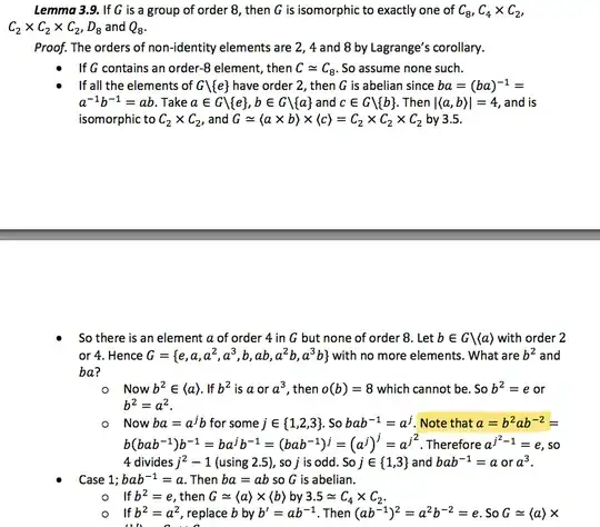

Ok so I am looking at a proof to all the groups of order 8, I've attached an image which basically is the start of the proof. In particular the part highlighted with yellow is causing me problem, I can see why it works (by subbing it into previous equations) but without being told a is of this form, how do you get an insight to write a in this form?
Thanks
