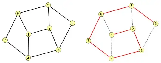

Not an answer but a comment on the problem:
I think the enumeration of such rearranged sequences is a graph theory question. Consider the undirected graph $G_n$ whose nodes are the numbers from $1$ to $n$. Draw an edge between $a$ and $b$ if $a+b$ is prime. Then by Bertrand's postulate you get a connected graph.
Arrangements of the numbers such that the sum of any two consecutive numbers is prime correspond to Hamiltonian paths of $G_n$. An example for $n=8$:
Note that the graph is bipartite. This gives you methods to find prime arrangements in $O(1.5^n)$ rather than $O(n!)$ as required for the brute force approach.
However I doubt that it really helps to prove for which numbers such an arrangement exists.

    I'm just... wow. Great answer. +1 – Patrick Da Silva Jan 27 '14 at 23:11

    Patrick Da Silva: Many thanks :) @user1324816 Yes, but for the data structure you may choose any existing library (or any standard way to represent graphs). Concerning the Hamiltonian path search, there are not only optimized exact algorithms but lots of randomized algorithms which are really fast. I implemented one and found that for $n<100$ the graph $G_n$ has always a Hamiltonian path. I can share the code if you like, but unlike your own code, mine is in Python. – benh Jan 28 '14 at 01:54
  • @benh Please do send me the code. Do you have a github repo? – user6123723 Jan 28 '14 at 02:02
    Yes, I created an MSE repo. It has an implementation of a Hamiltonian path search for the mentioned prime graphs in Python 2.7. Have fun with the code :). https://github.com/bheuer/MSE/blob/master/HamiltonianPathInPrimeGraph.py By the way, I checked up to $n\leq 1000$ and there was always a Hamiltonian path. – benh Jan 28 '14 at 03:35
