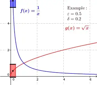

This intuitive GIF image from Wikepedia helped me most.
$f(x)=\frac{1}{x}$ as shown in the image is continuous but not uniformly continuous, because obviously if, for instance when $x_1=0.1$ we can see that $|f(x_1)-f(x_1+0.2)| \gt 0.5$; while $g(x)=\sqrt x$ is both continuous and uniformly continuous since we can find a number, for instance 0.5 bellow, such that $|f(x_1)-f(x_1+0.2)| \lt 0.5$ for every $x_1$. Here 0.2 and 0.5 should be numbers in R which just exist for the given function.
Hope this will be of any help to you.
