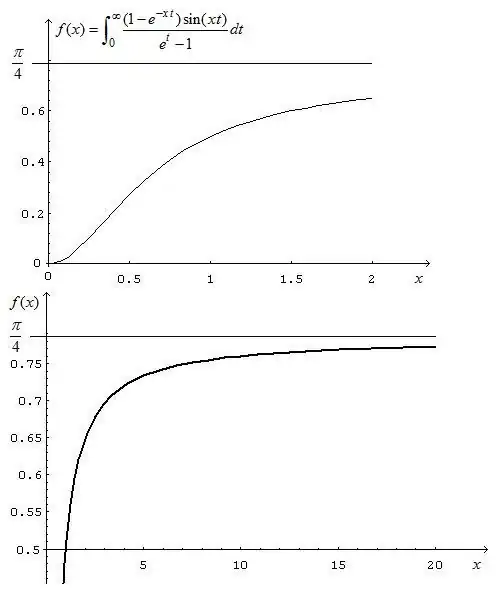

The finite series can be expressed in terms of digamma function : enter image description here
Using the integral definition of the digamma :
The finite series can be expressed as a function defined by an integral:
Then the function with integer n is extended to the positive reals x :
The function $f(x)$ is continuous and can be graphically represented :
This shows that $f(x)$ is continuously increassing. As a consequence, we can extend the initial question $f(n+1)>f(n)$ to an extended one $f(x+r)>f(x)$ where $x$ and $r$ are any positive reals.
Of course, the graphical presentation is not an analytical proof.
JJacquelin
