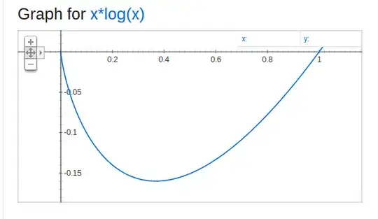

But maybe you really want to prove the derivative wrt $p$ is positive; after all, this gives more information than the function being strictly increasing. Then do the following: normalize $a_i$ (multiplying them by the same positive constant) so that $\sum a_i^p =1$. The scary inequality $$ \left(\frac{-1}{p^2}\right) \log (a_1^p + \dotsb + a_n^p)+ \frac1p \frac{a_1^p \log a_1+ \dotsb + a_n^p \log a_n }{a_1^p + \dotsb + a_n^p}+\frac{1}{p^2}\log n\ge 0$$ suddenly simplifies to $$ \frac1p (a_1^p \log a_1+ \dotsb + a_n^p \log a_n )+\frac{1}{p^2}\log n\ge 0$$ Writing $b_i=a_i^p$ simplifies it further: $$ \sum b_i \log b_i \ge \log (1/n) \tag{1}$$ with equality iff all $b_i$ are equal. You may have seen (1) in the context of entropy. Jensen's inequality yields (1) because the function $x\mapsto x\log x$ is convex on $[0,1]$.
x log x
