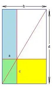

Would a picture help? enter image description here
Note that $\frac{a}{b} = \frac{c}{d}$ by similar triangles. The blue and green rectangle has area $ad$ while the green and yellow rectangle has area $bc$. These are equal, namely fraction $\frac{a}{b} = \frac{c}{d}$ of the area of the big rectangle.

    Well, I know that the two areas should be equal, but I do not see that at all. In fact, just from the picture I would say that the green and yellow rectangle has a larger area. – Srivatsan Sep 15 '11 at 15:00
  • 15
    @Srivatsan: One way to see the areas are equal: The red line divides the $b\times d$ rectangle in half. The two white triangles have the same area, and the two green triangles have the same area. (Since in both cases they are half of a rectangle) Hence the yellow and blue square have the same area. (Otherwise the biggest two triangles would not have the same area) – Eric Naslund Sep 15 '11 at 17:39
  • @Eric Nice. That's more intuitive. – Srivatsan Sep 15 '11 at 17:40
