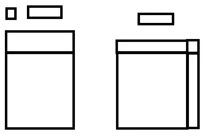

Please forgive my poor mspaint skills. On the left, I've represented a quadratic by drawing its square part, its linear part, and some left over constant parts. On the right, we've chopped the linear part in half and reassembled things into a larger square with some left over constant parts, but no linear part.
I have no idea if the actual etymology has any resemblance to this.

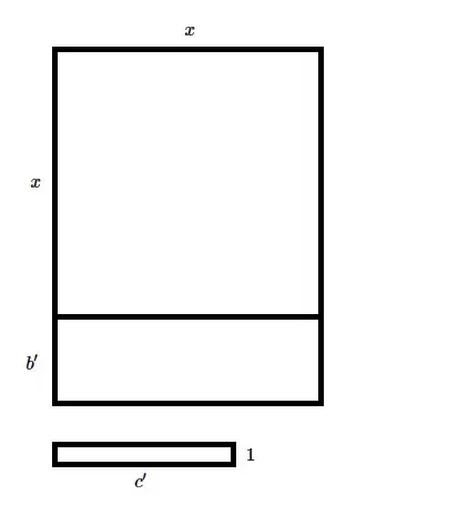

Here are an approach that is similar to the one I use to teach the concept to my own students. (I generally do this with a quadratic of the form $x^2+bx+c,$ as it simplifies the arguments, and the more general case can be scaled at the beginning and end to work similarly.)
Note that if we start with a general quadratic $ax^2+bx+c,$ we could picture it as the total volume of three box-shaped solids with the following respective dimensions:
  • $a\times x\times x,$
  • $1\times b\times x,$
  • $1\times c\times 1.$
This makes things slightly more complicated to draw, though, so as an alternative, letting $b'=\frac ba$ and $c'=\frac ca,$ we will instead consider it as the total volume of three box-shaped solids with the following dimensions:
  • $a\times b'\times x,$
  • $a\times c'\times 1.$
Putting the first two together and leaving the third floating loose, we obtain two box-shaped solids having height $a,$ with bases having the following respective dimensions:
  • $x\times(x+b'),$
  • $c'\times 1.$
Since we're considering only box-shaped solids with the same height, then the bases of the solids pretty much tell us the whole story about their total volume (and are easier to draw than the $3$-dimensional alternative):
stage 1

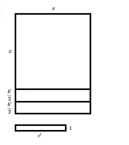

Now, let's split the solid with the $b'\times x$ base into two solids with bases of dimension $\frac{b'}2\times x.$ This gives us:
stage 2

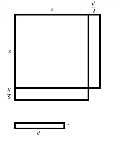

Now, let's slide one of the two solids we've made around to the right side of our solid with the $x\times x$ base. This gives us:
stage 3

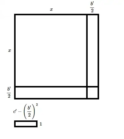

Now, we're very close to having a box-shaped solid with a square base of dimension $\left(x+\frac{b'}2\right)\times\left(x+\frac{b'}2\right)$ (together with a floating box-shaped solid of the same height), but the square-based box-shaped solid isn't quite complete. All that is missing is a box-shaped solid of height $a$ with base dimensions $\frac{b'}2\times\frac{b'}2.$ To obtain the missing portion, we will remove a box-shaped solid of dimensions $a\times\left(\frac{b'}2\right)^2\times 1$ from the floating box-shaped solid, leaving a box-shaped solid with dimensions $a\times\left(c'-\left(\frac{b'}2\right)^2\right)\times 1,$ then we will reshape the removed box-shaped solid into a box-shaped solid of dimensions $a\times\frac{b'}2\times\frac{b'}2.$ This reshaped solid fits nicely into the missing corner, giving us:
stage 4
So, we subtracted from the floating solid (which represented the constant term) and added what we took onto the other solid to complete the square-based box-shaped solid (which began as the sum of our other two terms).
