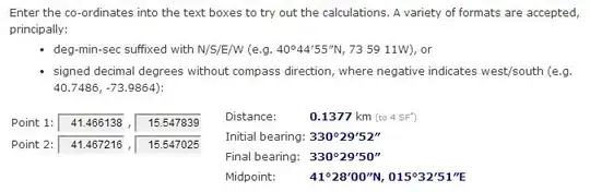

1) I have used the Haversine forumla that using this site gives me the following result:
So the mesured distance using the Haversine formula is 137,7 meters.
