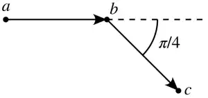

Consider the two adjacent sides of a regular octagon pictured below
$\hspace{5cm}$enter image description here
First, since the sides have equal length, we have $$ \begin{align} (c-b)\cdot(b-a) &=|c-b|\,|b-a|\cos(\pi/4)\\ &=\frac{|b-a|^2}{\sqrt2} \end{align} $$ Thus, we have $$ \sqrt2=\frac{(b-a)\cdot(b-a)}{(c-b)\cdot(b-a)} $$ If all the coordinates are rational, then the quantity on the right is rational. However, since $\sqrt2$ is not rational, that is impossible.
