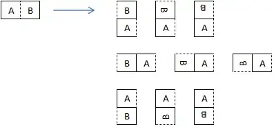

For $1 \times 2$, there are $9$ valid reconfigurations, namely those made from the various combinations of matching any of the $3$ straight edges of $a_{1,1}$ with any of $3$ straight edges of $a_{1,2}$ (here pictured as A and B, respectively, because re-doing work in Excel wore me out):
all 9 valid reconfigurations of the 1-by-2 puzzle

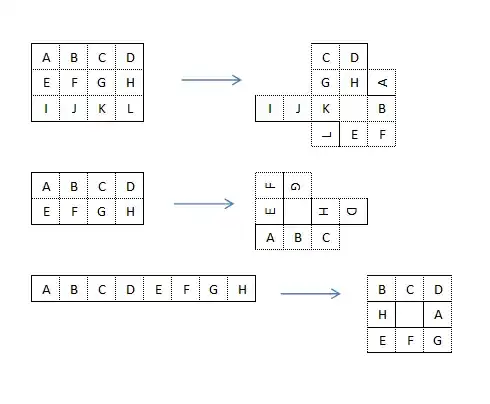

Holes for slightly larger puzzles
Holes may arise in valid reconfigurations:
examples of valid reconfigurations with holes
The example above shows three different puzzles and a valid reconfiguration for each one that happens to have a hole. (Straight edges are solid, and internal edges are dotted, even though different dotted edges may only join if they're joined in the original. In a real puzzle these are the unique squiggly cuts resulting in two pieces sharing a pair squiggly parts that can only fit each other.) The top $3 \times 4$ puzzle's reconfiguration has a hole with all internal edges, the middle $2 \times 4$ puzzle's reconfiguration has a hole with a mix of internal edges and straight edges, and the bottom $1 \times 8$ puzzle's reconfiguration has a hole with all straight edges. All of these are valid reconfigurations.
