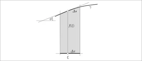

Similarly, when you have a plane curve $\gamma:\ s\mapsto {\bf z}(s)=\bigl(x(s),y(s)\bigr)$, it's bending energy $J$ is given by the integral $$J:=\int\nolimits_\gamma \kappa^2(s)\ ds\ ,$$ where $\kappa$ denotes the curvature. Don't think here of the precise logical meaning of $ds$, but of the intended thought process: The curve is cut up into $N$ pieces of length $\Delta s_k>0$, and the curvature of $\gamma$ is measured at a point ${\bf z}(\sigma_k)$ of each piece. Then one forms the sum $$R:=\sum_{k=1}^N \kappa^2(\sigma_k)\>\Delta s_k\ ;$$ and finally the "true" $J$ is the limit of such sums when the $\Delta s_k$ go to zero.
Now comes the question of "piece of area" vs. "piece of length". This question teaches us that we have to be careful when dealing with "little bits of something". Consider the following figure:
The "area under the curve" $\gamma$ corresponding to a certain $\Delta x>0$ is roughly $f(\xi)\cdot \Delta x$, independently of the exact slope of the curve at $\xi$. Making $\Delta x$ smaller will decrease the relative area error committed here. But the length $\Delta s$ of the short arc corresponding to $\Delta x$ is roughly $={\Delta x\over\cos\phi}$, and making $\Delta x$ smaller does not bring away the factor ${1\over\cos\phi}$. It follows that the final formula for the total length will have to incorporate the values ${1\over\cos\phi}=\sqrt{1+f'(\xi)^2}$.
