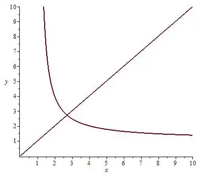

I asked Maple to plot the solutions to $x^y=y^x$ in the range $0 \le x, y \le 10$ and got the plot attached below. The diagonal line is the trivial solution $y=x$. The other is the LambertW solution.

  • If you plot that function you will not get exactly what we need. See this - so you are very close, but the function plots wrong mix of branches. We need I think a proper piece-wise definition do discard $x\neq y$ and another formula to pic up the upper branch. – iLie Dec 24 '13 at 23:13
  • @ILie You asked for a solution with $y$ as a function of $x$. The function I gave satisfies that request. If you allow $x$ to be a function of $y$ then you get a similar solution with $x$ and $y$ interchanged. Combining these two charts gives us the complete picture (which I also supplied). – Fly by Night Dec 25 '13 at 00:03
  • Your function has a part where x = y, which is against of one of the stated conditions. See attached image in my previous comment. – iLie Dec 25 '13 at 00:23
  • @ILie the image you attached also includes the line $x=y$ for small $x$. Your attached image is a proper subset of mine. Just as $y=\sqrt{x}$ is a proper subset of $y=x^{1/2}$. – Fly by Night Dec 25 '13 at 01:08
