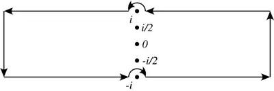

Contours
Since the integrand is even, $$ \begin{align} \int_0^\infty\frac{\sin(\pi x^2)}{\sinh^2(\pi x)}\,\mathrm{d}x &=\frac12\int_{-\infty}^\infty\frac{\sin(\pi x^2)}{\sinh^2(\pi x)}\,\mathrm{d}x \end{align} $$ Define $$ f(z)=\frac{\cos\left(\pi z^2\right)}{\sinh(2\pi z)\sinh^2(\pi z)} $$ Note that because $$ f(x\pm i) =\frac{-\cos\left(\pi x^2\right)\cosh(2\pi x)\pm i\sin\left(\pi x^2\right)\sinh(2\pi x)}{\sinh(2\pi x)\sinh^2(\pi x)}\\ $$ we have $$ \begin{align} \int_\gamma f(z)\,\mathrm{d}z &=\int_{-\infty}^\infty\big[f(x-i)-f(x+i)\big]\,\mathrm{d}x\\ &=-2i\int_{-\infty}^\infty\frac{\sin(\pi x^2)}{\sinh^2(\pi x)}\,\mathrm{d}x\\ &=2\pi i\times\begin{array}{}\text{the sum of the residues}\\\text{inside the contour}\end{array} \end{align} $$ where $\gamma$ is the contour
$\hspace{3.2cm}$enter image description here
Therefore, $$ \int_0^\infty\frac{\sin(\pi x^2)}{\sinh^2(\pi x)}\,\mathrm{d}x =-\frac\pi2\times\begin{array}{}\text{the sum of the residues}\\\text{inside the contour}\end{array} $$ Residues
near $0$ : $$ \begin{align} f(z) &=\frac{\cos\left(\pi z^2\right)}{\sinh(2\pi z)\sinh^2(\pi z)}\\ &=\frac{1-\frac12\pi^2z^4+O(z^8)}{2\pi z\left(1+\frac23\pi^2z^2+O(z^4)\right)\pi^2 z^2\left(1+\frac13\pi^2z^2+O(z^4)\right)}\\ &=\frac{1-\pi^2z^2}{2\pi^3z^3}+O(z)\\[10pt] &\implies\text{residue}=-\frac1{2\pi} \end{align} $$ at $\pm i/2$, use L'Hosptal : $$ \begin{align} \text{residue} &=\lim_{z\to\pm i/2}\frac{(z\mp i/2)\cos\left(\pi z^2\right)}{\sinh(2\pi z)\sinh^2(\pi z)}\\ &=\frac1{2\pi\cosh(\pm\pi i)}\frac{\cos(-\pi/4)}{\sinh^2(\pm\pi i/2)}\\ &=\frac1{2\pi\cos(\pm\pi)}\frac{\sqrt2/2}{-\sin^2(\pm\pi/2)}\\[4pt] &=\frac{\sqrt2}{4\pi} \end{align} $$ near $\pm i$ : $$ \begin{align} f(z\pm i) &=\frac{-\cos\left(\pi z^2\right)\cosh(2\pi z)\pm i\sin\left(\pi z^2\right)\sinh(2\pi z)}{\sinh(2\pi z)\sinh^2(\pi z)}\\ &=\frac{-\left(1-\frac12\pi^2z^4+O(z^8)\right)\left(1+2\pi^2z^2+O(z^4)\right)+O(z^3)}{2\pi z\left(1+\frac23\pi^2z^2+O(z^4)\right)\pi^2 z^2\left(1+\frac13\pi^2z^2+O(z^4)\right)}\\ &=-\frac{1+\pi^2z^2}{2\pi^3z^3}+O(1)\\[10pt] &\implies\text{residue}=-\frac1{2\pi} \end{align} $$ Result
Thus, $$ \begin{align} \int_0^\infty\frac{\sin(\pi x^2)}{\sinh^2(\pi x)}\,\mathrm{d}x &=-\frac\pi2\left(-\frac1{2\pi}-\frac1{2\pi}+\frac{\sqrt2}{4\pi}+\frac{\sqrt2}{4\pi}\right)\\[6pt] &=\frac{2-\sqrt2}{4} \end{align} $$

  • Actually, finding the proper $f$ was just a bit of experimentation. First, I looked at $$ \frac{\sin(\pi(x\pm i)^2)}{\sinh^2(\pi(x\pm i))}=\frac{-\sin(\pi x^2)\cosh(2\pi x)\mp i\cos(\pi x^2)\sinh(2\pi x)}{\sinh^2(\pi x)} $$ I noticed that subtracting one from the other left $2i\cos(\pi x^2)\sinh(2\pi x)$ in the numerator. So I tried $$ \frac{\cos(\pi(x\pm i)^2)}{\sinh^2(\pi(x\pm i))}=\frac{-\cos(\pi x^2)\cosh(2\pi x)\pm i\sin(\pi x^2)\sinh(2\pi x)}{\sinh^2(\pi x)} $$ – robjohn Jul 31 '13 at 12:19
  • which left $-2i\sin(\pi x^2)\sinh(2\pi x)$ in the numerator after subtraction. The $\sinh(2\pi x)$ is easy to get rid of: since $\sinh(2\pi(x\pm i))=\sinh(2\pi x)$, we can just divide it out. Thus, $$ \frac{\cos(\pi(x\pm i)^2)}{\sinh^2(\pi(x\pm i))\sinh(2\pi(x\pm i))}=\frac{-\cos(\pi x^2)\coth(2\pi x)\pm i\sin(\pi x^2)}{\sinh^2(\pi x)} $$ Therefore, we want to use $$ f(z)=\frac{\cos(\pi z^2)}{\sinh^2(\pi z)\sinh(2\pi z)} $$ – robjohn Jul 31 '13 at 12:19

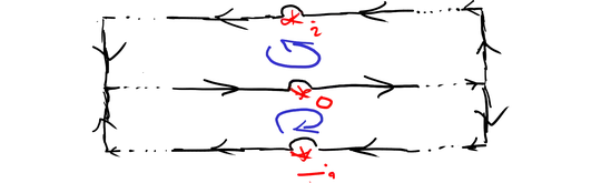

Not sure if anyone is interested in another solution after all those years, but anyway: I managed to evaluate the integral in a slightly different manner that doesn't depend on me coming up with a cleverly constructed function to integrate. However, cleverness is needed elsewhere in the process, so it's not much simpler than the other two solutions.
Define $\displaystyle f(z) = \frac{\mathrm{e}^{\mathrm{i}\pi z^2}}{\sinh^2 \pi z}$ and consider the two contours shown on the following sketch:
$f(z)$ has poles in all $\mathrm{i}n$ for $n \in \mathbb Z$; some of them are shown with red asterisks. Here the two rectangles extend to $\pm\infty$ on the sides, the little circles around the poles have radius $r > 0$ and the three horizontal lines are exactly the same, just shifted by $\pm \mathrm{i}$.
The residue of $f(z)$ in zero is obviously zero, because the Laurent series will contain only even powers. To calculate the residue in $z = \mathrm i$, write $w = z-\mathrm i$ and consider the fact that $\sinh^2 z$ is $\mathrm{i}$-periodic to obtain
$$ \frac{\mathrm{e}^{\mathrm{i} \pi (w^2 + 2\mathrm{i} w - 1)}}{\sinh^2 \pi w} = - \frac{1}{\pi^2 w^2} \frac{\mathrm{e}^{\mathrm{i} \pi w^2}}{(1 + \text{even powers of $w$})^2} (1 - 2\pi w + \cdots)$$
The only way to get the minus first power is to take the $-2\pi w$ in the last parentheses and 1's in the expansions of the other two functions. Hence the residue is $2/\pi$.
Now denote $\displaystyle I = \int_K f(x)\,\mathrm{d} x$, where $K$ is the horizontal line with a little circle around 0. Writing the residue theorem for the top and the bottom contour on the sketch, we get
$$\begin{align*} \int_K f(x)\,\mathrm{d} x - \int_K f(x+\mathrm{i})\,\mathrm{d} x &= 2\pi\mathrm{i} \times \frac{2}{\pi} &\implies&& \int_K \frac{\mathrm{e}^{\mathrm{i} \pi x^2} \mathrm{e}^{-2\pi x}}{\sinh^2 \pi x}\,\mathrm{d} x &= 4\mathrm{i} - I \\ \int_K f(x)\,\mathrm{d} x - \int_K f(x-\mathrm{i})\,\mathrm{d} x &= 0 &\implies&& \int_K \frac{\mathrm{e}^{\mathrm{i} \pi x^2} \mathrm{e}^{2\pi x}}{\sinh^2 \pi x}\,\mathrm{d} x &= - I \\ \end{align*}$$
Add the two equations together and subtract $\displaystyle 2 \int_K \frac{\mathrm{e}^{\mathrm{i}\pi x^2}}{\sinh^2 \pi x}\,\mathrm{d} x = 2I$ to get $$ \int_K \frac{\mathrm{e}^{\mathrm{i} \pi x^2} (\mathrm{e}^{2\pi x} - 2 + \mathrm{e}^{-2\pi x})}{\sinh^2 \pi x}\,\mathrm{d} x = 4\mathrm{i} - 4I. $$ However, $\sinh^2 \pi x = \frac14 (\mathrm{e}^{\pi x} - \mathrm{e}^{-\pi x})^2$, so the parenthesis in the numerator is $4\sinh^2 \pi x$. The sinh's cancel and we get $4 \int_K \mathrm{e}^{\mathrm{i} \pi x^2}\,\mathrm{d} x = 4\mathrm{i} - 4I$.
Taking the imaginary part of the last equality, sending $r \to 0$ to get rid of the small circle around the pole in $0$ (we couldn't do this earlier because the real part of the integral over the little circle actually diverges; however, the residue is 0, so, once we get rid of the divergence, there will be no contribution) and dividing by 8, we get $$ \frac12 \int_{-\infty}^\infty \sin \pi x^2\,\mathrm{d} x = \frac12 - \frac12 \int_{-\infty}^\infty \frac{\sin \pi x^2}{\sinh^2 \pi x}\,\mathrm{d} x. $$ Both integrands are even, so we can write $\int_{-\infty}^\infty = 2 \int_0^\infty$. The integral on the left is one of the well-known Fresnel integrals and it is equal to $\frac{1}{2\sqrt2}$, so we truly obtain the result
$$\int_0^\infty \frac{\sin \pi x^2}{\sinh^2 \pi x}\,\mathrm{d}{x} = \frac12 - \frac{1}{2\sqrt2} = \frac{2-\sqrt2}{4}.$$
