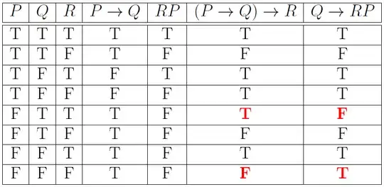

Now on a side note, in my original question I claimed that $R\rightarrow(P\rightarrow Q)$ is equivalent to $RP\rightarrow Q$. I also claimed that $(P\rightarrow Q)\rightarrow R$ was logically equivalent to $Q\rightarrow RP$ which I disprove in the truth table below: enter image description here

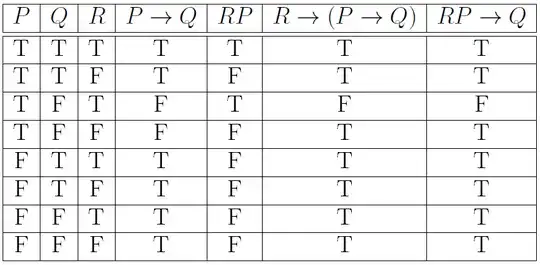

Additionally I added the following truth table to confirm $RP\rightarrow Q$:
