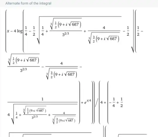

In Wolfram Alpha the integral for $c=4$ and $k=3$ can be computed with the one-liner:
Integrate[1/Sum[(E^(Round[Log[n]*4]/4))^(x), {n, 1, 3}],x]
A screen dump for the one-liner from Wolfram Alpha for Alternate form of the integral, begins:
Wolfram Alpha capture of Alternate Form of Integral
The first few lines of the output of Mathematica looks like this:

Wrapping the RootSum[ ] with the Normal[ ] command:
Normal[RootSum[ 1 + #1^5 + #1^8 &, (s - 7 Log[E^(s/7) - #1])/(8 + 3 #1^5) &]]
gives an output that begins:
((s - 7 Log[E^(s/7) - Root[1 + #1^5 + #1^8 &, 1]])/( 8 + 3 Root[1 + #1^5 + #1^8 &, 1]^5)) +...
where Root[1 + #1^5 + #1^8 &, 1] means the first root of the polynomial: $1+x^5+x^8$ which seems to follow the pattern of 5 and 8 in the powers in: 1/(1 + E^(5 x/7) + E^(8 x/7)) in the beginning of the same row in the Mathematica output.
