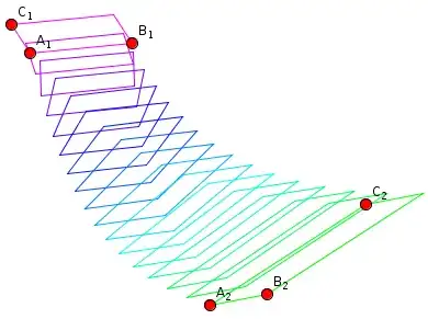

I've created a proof of concept implementation which you can use to experiment, in order to decide whether this is what you want. Here is a snapshot of the kind of interpolation this will create:
Interpolation snapshot
With that experiment, I realized that one should include the translative part into the matrix as well, in just the way you composed a matrix including $A$ and $b$ in your question. Otherwise, the positions of the interpolated frames will depend on the location of the defining triples in the plane, which I consider undesirable.
