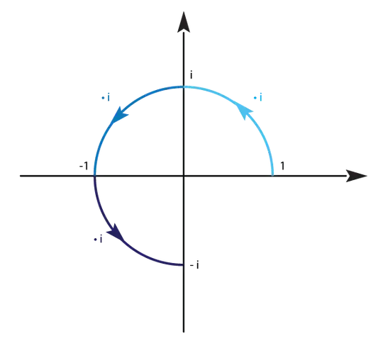

Multiplying by $i$ in the complex plane amounts to a counterclockwise turn of $90$ degrees. Hence it is geometrically clear that $i^3 = -i$, as the following drawing shows
Regarding your equations, as remarked already, $\sqrt{a}\sqrt{b}=\sqrt{ab}$ holds only for positive real $a$ and $b$, so you cannot use it with complex numbers.
