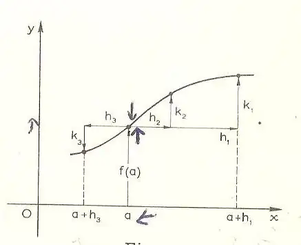

I assume you are familiar with the notion of the limit of a sequence $(x_{n}) $. The limit of a function $f(x)$ when $x$ tends to $a$ is $b$ if and only if for any sequence $(x_{n})$ of values of $x$ approaching $a$ but different from $a$ the corresponding sequence $y_{n}=f(x_{n})$ of values of the function approaches $b$.
[Edited] A function $f(x)$ is continuous at $a$ if and only if (see figure)
  1. $a$ is on its domain and
  2. the difference $k=f(x)-f(a)$ tends to $0$ when the difference $h=x-a$ approaches $0$. (In other words, when for any sequence $h_1=x_1-a,h_2=a-x_2$, $h_3=a-x_3,\dots$ approaching $0$ but different from $0$, the corresponding sequence $k_1=f(x_1)-f(a),k_2=f(x_2)-f(a),k_3=f(x_3)-f(a),\dots$ tends to $0$).
