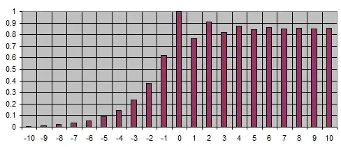

Here's another solution, following Ross Millikan's hint:
Let $n=H−2T$ (H=heads, T=tails). At each step, $n := n+1 $ or $n := n-2$ with probability 1/2. The game starts with $n=0$ and stops when $n=0$.
For any iteration (after the initial), let $P(n)$ be the probability that the game eventually stops, given the current value of $n$ (and given that the event has not yet occurred). It's clear that $P(n)$ does not depend on time. Then the following recurrence holds:
$$P(n)= \frac{P(n+1)+P(n-2)}{2} \;, \;\; n\ne 0 $$
with $P(0)=1$. We also know (do we?) that $P(-\infty)=0$ (but we don't yet know $P(+\infty)$)
The solution to this difference equation (I'll spare you the details, just the usual linear difference equation procedure, in the two regions, with the above boundary conditions) is given by:
$$ P(n)= \left\{ \begin{array}{ll} \phi^{-n} & \mbox{if } n \le 0 \\ 1 + B \, [(-\phi)^n -1] & \mbox{if } n \ge 0 \end{array} \right. $$
with $ B= \phi^2 (1-\phi)$, $\phi = (\sqrt{5}-1)/2$
Now, after the first step we have $n=1$ or $n=-2$ with equal probability, then the probability that the game eventually stops is
$$\frac{P(1)+P(-2)}{2}=\frac{2 \phi^2 -\phi +1}{2} = 0.572949$$
The form of $P(n)$ is interesting:
This, for example, shows that the probability of stop is strongly dependent on the first coin toss (less than 40% if tail, more than 75% if head).
This procedure also seems directly generalizable, either to asymmetric coins or other integer ratios.

We postulate a solution of the form $P(n)= r^n$ and replacing in the recursion $2 P(n) - P(n+1) - P(n-2) = 0 $ we get $$2 \; r^2 - r^3 - 1 = 0 $$ The root $r_1=1$ comes immediately, and then the others: $r_2 = - \phi$, $r_3 = 1/\phi$. Then the general solution is given by $A + B (-\phi)^n + C \phi^{-n}$, for some $A,B,C$, in each zone.
In the zone $n \le 0$: we have $P(0)=1$ and $P(-\infty)=0$. As $\phi \approx 0.618 < 1$, this implies $A=0$, $B=0$,$C=1$ Hence
$$P(n) = \phi^{-n} \hspace{10px} n \le 0$$
In the zone $n \ge 0$: we have $P(0)=1$, but we don't know $P(\infty)$. We do know it's bounded, so $C=0$, and $A=1-B$, so
$$P(n) = 1 + B \, [(-\phi)^n -1] \hspace{10px} n \ge 0$$
To get rid of the remaining degree of freedom, we write the recursion for $n=1$, and replace the value of $P(-1)$ for the previous solution:
$$ 2 \, P(1) = P(2) + P(-1)$$ $$ 2 \, (1 + B \, [-\phi -1]) = 1 + B \, [(-\phi)^2 -1] + \phi$$
From this, we obtain $B= \phi^2 (1-\phi)$.

  • This solution is beautiful! One thing I don't understand is, how did you set boundary conditions for the region n >= 0? – Elliott Aug 29 '11 at 16:34
  • @Elliot: You first solve for $n \le 0$, then plugging it in the recursion for $n=1$ you resolve the remaining degree of freedom. Tell me if this is not clear, and I'll write the details. – leonbloy Aug 29 '11 at 17:44
  • So... in the end, you know that P(-infty)=0? – Did Aug 31 '11 at 21:01
    Well, we "knew" (actually assumed) that from the beginning, it was $P(+\infty)$ the unknown. It's true (are you pointing to this?) that $P(-\infty)=0$ is intuitive and true but a rigorous proof is lacking here. – leonbloy Aug 31 '11 at 21:19
  • Just pointing to the fact that, when P(-infty) first appear, you feel necessary to signal that the relation P(-infty)=0 might need a proof. But when you need the value of P(-infty) later on, you state it without further ado. Hence, reading your post, I was wondering if I had missed, somewhere inbetween these two appearances, a proof that P(-infty)=0. (Please use @.) – Did Sep 01 '11 at 13:22
  • @Didier: Yes, that's the weak point of my post. A proof is not difficult to find, but it doesn't follow from the rest of the approach. An argument very similar to your answer to this post would fit the bill http://math.stackexchange.com/questions/49631/when-random-walk-is-upper-unbounded – leonbloy Sep 01 '11 at 14:04
  • @leon, I agree with everything you wrote in your last comment. – Did Sep 01 '11 at 22:03
  • I found B=(1-\phi)/(1+\phi)^2 and was going mad until I realized that's equal to B=(1-\phi)\phi^2 as you report. Relief. Nice answer. – PatrickT Sep 27 '18 at 10:50
