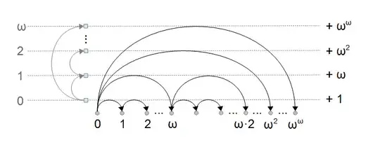

I wonder if the following might be a more compelling way to visualize ordinal numbers up to $\omega^\omega$:
My questions are:
  1. (Where) has this way of visualization been suggested before?
  2. How far can it been generalized by repeating the indicated step in a transfinite way?
The "indicated step" is: rotating the picture by 90° counter-clockwise.

  • Sorry for that! The first one - the more complicated one - you find at http://en.wikipedia.org/wiki/Ordinal_numbers. I don't have to do with it. The second one I have to explain, obviously. I'll do my best as soon as possible! – Hans-Peter Stricker Dec 09 '13 at 01:05
    I can actually understand the first (after looking at it for a few more minutes), the second somehow suggests that the order type is $\omega^\omega+1$. Don't use me as a test case, I was never good in understanding visual aids. – Asaf Karagila Dec 09 '13 at 01:06
    The first is just my usual linear picture wrapped into a spiral; it makes perfectly good sense to me. – Brian M. Scott Dec 09 '13 at 01:07
    First one makes sense to me, though I usually draw it in a line instead of a spiral. Bottom one doesn't make sense after $\omega\cdot 2$ along the horizontal axis, and I have no idea what's happening on the vertical. – Amit Kumar Gupta Dec 09 '13 at 01:16
  • @AmitKumarGupta $\omega \cdot 2, \omega \cdot 3, \ldots, \omega \cdot \omega = \omega ^2, \omega ^3, \ldots ,\omega ^\omega$ – Git Gud Dec 09 '13 at 01:18
  • I should have spelled out: (immediately) after $\omega\cdot 2$ there is $\omega\cdot 2 + 1$, and on the vertical axis same things happen as on the horizontal one. – Hans-Peter Stricker Dec 09 '13 at 01:22
