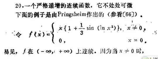

and I find somebook,and I found this enter image description here
This follow famous example(Pringsheim) is $f$ is continuous strictly increasing function,and there exsit a point not differentiable $$\begin{cases} x(1+\dfrac{1}{3}\sin{(\ln{x^2})}&x\neq 0\\ 0&x=0 \end{cases}$$
we can show $f$ is strictly increaing and continuous on $R$,but $x=0$,$f$ is not differentable.
