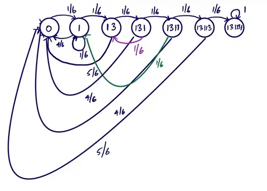

I thought I would add my solution to this here as well, in case it may help others. There are other ways to do this. One is a way to do this using Markov Chains. This will work even in cases when the dice is not a fair dice.
Markov Chain Method
You can construct the chain as follows (I just used different colors to disambiguate):
Let state 0 be nothing i.e. similar to starting afresh.
Note that state 131131 is absorbent i.e. $P($state 131131 to state 131131$)\ = 1$.
Let $\psi(i)$ be the expected number of throws to reach state 131131 from state $i$
We now have equations as follows:
$\psi(13113) = 1 + \frac{5}{6}\psi(0)$
$\psi(1311) = 1 + \frac{1}{6}\psi(1) + \frac{4}{6}\psi(0) + \frac{1}{6}\psi(13113)$
$\psi(131) = 1 + \frac{1}{6}\psi(13) + \frac{4}{6}\psi(0) + \frac{1}{6}\psi(1311)$
$\psi(13) = 1 + \frac{5}{6}\psi(0) + \frac{1}{6}\psi(131)$
$\psi(1) = 1 + \frac{1}{6}\psi(1) + \frac{4}{6}\psi(0) + \frac{1}{6}\psi(13)$
$\psi(0) = 1 + \frac{5}{6}\psi(0) + \frac{1}{6}\psi(1)$
Solve the system of equations for $\psi(0)$ i.e. the expected number of throws to reach 131131 from state 0. You will get:
$\psi(0)=46878$
