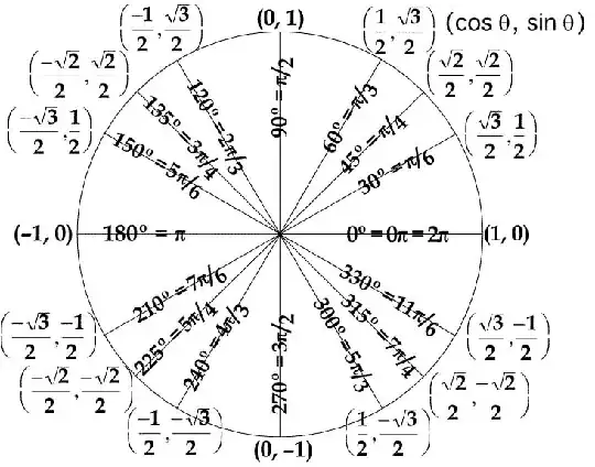

But, this isn't what the question is asking. It is simply asking if it is possible to do so and for me to prove it. I know that $\frac{3\pi}{9}$ can be simplified to $\frac{\pi}{3}$ and that exact values for the sine and cosine of it can be expressed cleanly and other multiples that can be reduced down to $\frac{\pi}{6}$, $\frac{\pi}{4}$, $\frac{\pi}{3}$ etc.
But how can I prove that $\frac{\pi}{9}$ itself can be expressed as an exact value?

Unit circle:Unit circle
