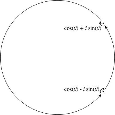

This integral does not converge due to the singularity near $x=\theta$. However, we can compute the Cauchy Principal Value of the integral. $$ \int_0^\pi\frac{\mathrm{d}x}{\cos(\theta)-\cos(x)} =\frac12\int_0^{2\pi}\frac{\mathrm{d}x}{\cos(\theta)-\cos(x)} $$ Use $z=e^{ix}$ where $\frac{\mathrm{d}z}{z}=i\,\mathrm{d}x$ and $\cos(x)=\frac{z+1/z}2$ since $z$ is on the unit circle. $$ \begin{align} \frac12\int_0^{2\pi}\frac{\mathrm{d}x}{\cos(\theta)-\cos(x)} &=\frac1{2}\int_\gamma\frac{-i\,\mathrm{d}z}{z\left(\cos(\theta)-\frac{z+1/z}{2}\right)}\\ &=\int_\gamma\frac{i\,\mathrm{d}z}{z^2-2z\cos(\theta)+1}\\ \end{align} $$ The integrand has two singularities at $z=\cos(\theta)\pm i\sin(\theta)$. Consider the contour:
$\hspace{3.2cm}$enter image description here
The principal value is the integral along the circle without the small semicircles. The integral along the whole contour is $0$ and the integral along each small semicircle is $-\pi i$ times the residue at the associated singularity.
The residue at $z$ is $\frac{i}{2z-2\cos(\theta)}$. Thus,
the residue at $z=\cos(\theta)+i\sin(\theta)$ is $+\frac1{2\sin(\theta)}$, and
the residue at $z=\cos(\theta)-i\sin(\theta)$ is $-\frac1{2\sin(\theta)}$
Therefore, the sum of the integrals along the small semicircles is $0$ and so $$ \mathrm{PV}\int_0^\pi\frac{\mathrm{d}x}{\cos(\theta)-\cos(x)}=0 $$
