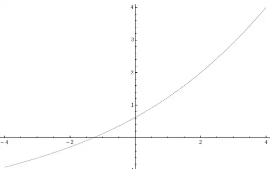

Here is a graphic for iterative root of $g(x)=(\sqrt{2})^x$

How can you compute a solution for $a=\sqrt2$ while you wrote " (...) does not converge where $a \le e^{1/e}$ (...)" ? And how can we approximate a solution when in the third formula high iterates of $g(x)$ are required and the base is greater than $e^{1/e}$ ? – Gottfried Helms Dec 25 '14 at 12:37
@Gottfried Helms typo. It does not converge when $a > e^{1/e}$, of course. – Anixx Dec 25 '14 at 13:24
I see.
(big relief!) Thank you for clarification. P.s. Did you know that I made a comparision between the computation which you called the Newton-series (when I did it I didn't know that my computations were equivalent to that) and an approach which involves diagonalization? In that discussion the diagonalization-approach was characterized by the property that it converges to the same solution, but much faster (with less terms). If you're interested: http://go.helms-net.de/math/tetdocs/index.htm , see the third entry "comparision of two methods" – Gottfried Helms Dec 25 '14 at 15:02
