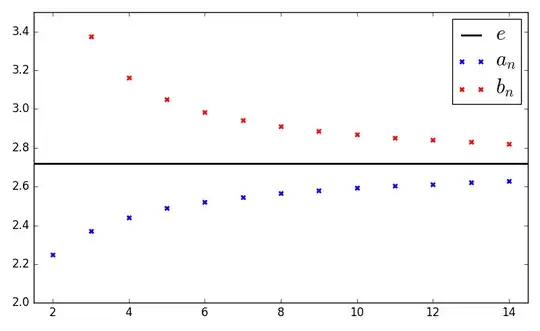

I had originally written this up for another question but it seems fitting here as well. Maybe this can help someone.
Depending on how you introduced $e$, you might be able to use the fact that there are two sequences $(a_n)_{n \in \mathbb{N}}$, $(b_n)_{n \in \mathbb{N}}$ with
$$\begin{align} a_n ~~~&:=~~~ \left ( 1 + \frac{1}{n} \right ) ^n \\ ~ \\ b_n ~~~&:=~~~ \left ( 1 - \frac{1}{n} \right ) ^{-n} \end{align}$$
and
$$\underset{n \rightarrow \infty}{\lim} a_n ~~~=~~~ \underset{n \rightarrow \infty}{\lim} b_n ~~~=~~~ e \\ ~ \\$$
While both sequences converge to the same limit, $a_n$ approaches from the bottom and $b_n$ approaches from the top:

So we're going to use the following inequality:
$$\forall n \in \mathbb{N} ~ : ~~~~~ \left ( 1 + \frac{1}{n} \right ) ^n ~~~~<~~~~ e ~~~~<~~~~ \left ( 1 - \frac{1}{n} \right ) ^{-n} \tag*{$\circledast$} \\ ~ \\$$
