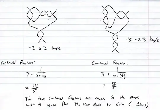

Since no one mention it, I think it's really pleasant knowing that every rational tangle correspond to some continued fraction(Conway showed that).
For further information see:
Here is good expository article:
Note:Image source: http://rationaltangle.wordpress.com/what-are-tanglesrational-tangles/
