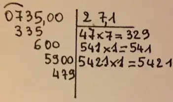

Here is how I write it by hand :

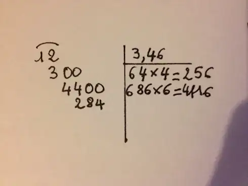

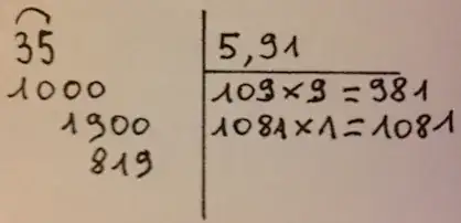

Now let me do it for $12$ and $35$ : (It took me like 30 seconds for each of them)
