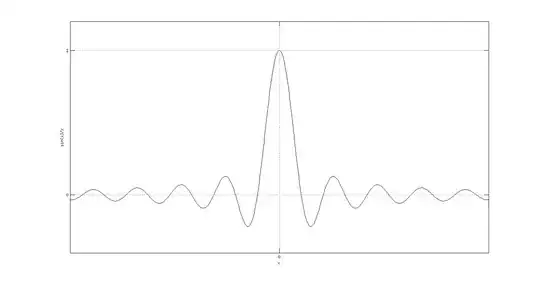

$$\frac{\sin(x)}{x} = 1$$ and $$\frac{1-\cos(x)}{x} = 0$$
I can't come up with any solution. Could you please help me?

$\sin(x) = x$ for small values of $x$; i.e. $\sin(x)$ and $x$ have the same evolution. So $$\lim_{x\rightarrow 0}\frac{\sin(x)}{x}=\lim_{x\rightarrow 0}\frac{x}{x}=\lim_{x\rightarrow 0}1=1$$
