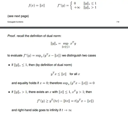

For norm, conjugate is indicator of unit ball for dual norm.
See Conjugate Functions at page 7-9:
By Lieven Vandenberghe.
