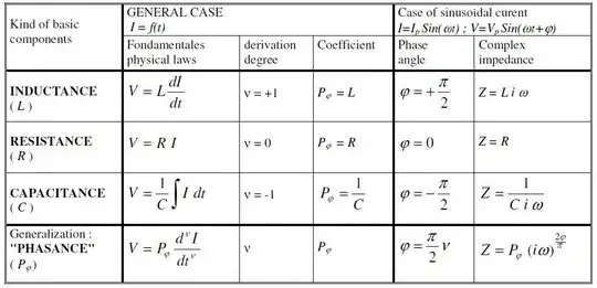

I would mention this table, from https://fr.scribd.com/doc/14686539/The-Fractional-Derivation-La-derivation-fractionnaire , which shows a generalization of the basic electrotechnical components, thanks to the fractional differ-integration :
This is an interresting generalization especially in the field of impedance analysis. It makes understandable why the semi-circular complex impedance diagrams, with the center of circle depressed below the real axis, are so commonly observed in practice : https://fr.scribd.com/doc/71923015/The-Phasance-Concept
