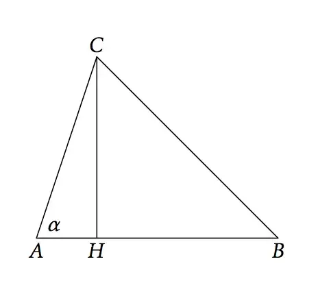

Consider the triangle in the following figure
If we call $a=BC$, $b=AC$, $c=AB$ (I omit the bar to denote the length for simplicity) and $d=AH$ (where $CH$ is the perpendicular to $AB$), we can easily see by a double application of Pythagoras' theorem that $$ a^2=b^2+c^2-2cd $$ or, introducing the cosine, $$ a^2=b^2+c^2-2bc\cos\alpha. $$

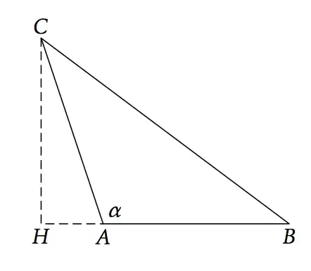

Suppose now we have an obtusangle triangle
With the same notation as before, we have $$ a^2=b^2+c^2+2cd $$ or, introducing the cosine $$ a^2=b^2+c^2+2bc\cos(\pi-\alpha) $$ because now $d=b\cos(\pi-\alpha)$. By defining $$ \cos\alpha=-\cos(\pi-\alpha) $$ for an obtuse angle $\alpha$, the relation $$ a^2=b^2+c^2-2bc\cos\alpha $$ (al-Kashi theorem) holds for all triangles. It only remains to supplement the definition of $\cos(\pi/2)$, but by Pythagoras' theorem we need to set $$ \cos\frac{\pi}{2}=0 $$

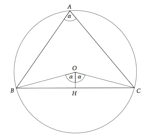

For the sine, the reasoning can start from the sine's theorem:
The figure, with some simple reasoning, gives $$ a\sin\alpha=2R $$ where $R=OB=OC=OA$. If you take the diametral opposite point $A'$ and of $A$, you immediately get that the sine of the supplementary angle $\alpha'$ of $\alpha$ must obey, if its sine were defined, $$ a\sin\alpha'=2R $$ that means $$ \sin(\pi-\alpha)=\sin\alpha. $$ Again, this forces us to set $\sin(\pi/2)=1$, which agrees with $\cos(\pi/2)=0$. For the zero angle, we can use the complementary angle rules to conclude we have to define $\sin0=0$ and $\cos0=1$.

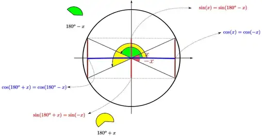

Because, if you take $\cos(180°-x)$ you are effectively getting the opposite of $\cos(x)$. Due to $180°$ being halfway over the circle diameter. So if you do take the opposite of that $-\cos(180°-x)$ you get $x$ back, because you switch the sign.
Easy to see with this image:
