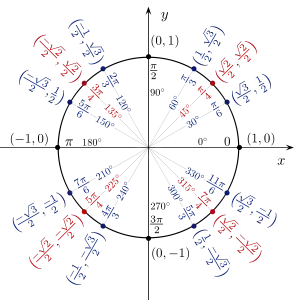

    Leon - if you look at the unit circle posted below, you'll see that the main angles you'll want to know (in radians) are the sines and cosines of $\theta = \pi/6,;\theta = \pi/4,; \theta = \pi/3$, and of course, $\theta = \pi/2,;\pi,;3\pi/2, \text{ and }; \theta = 0 = 2k\pi$. Other multiples of those angles are simply a matter of locating the quadrant and determining the correct sign. – amWhy Nov 14 '13 at 18:34

What you'll also likely want to do is evaluate $\cos \theta, \sin\theta$ for each $\theta.$ The trigonometric values needed here are for angles that are fairly basic, so you'll want to re-familiarize yourself with the standard angles, expressed in radians, and the corresponding trig values with those angles as arguments. See this link, and the image below, both from Wikipedia.
Taking your final work, but evaluating the $\sin$ and $\cos$ of the angles gives us an explicit representation of the cube roots of $-8$: $$ k = 0, z= 2(\cos(\frac{\pi}{3}) + i\sin(\frac{\pi}{3})) = 2\left(\frac 12 + i\frac {\sqrt 3}{2}\right) = 1 + i\sqrt 3\\ k = 1, z= 2(\cos(\pi) + i\sin(\pi)) = 2\left(-1 + i\cdot 0\right) = -2\\ k = 2, z= 2(\cos(\frac{5\pi}{3}) + i\sin(\frac{5\pi}{3}))= 2\left(\frac 12 - i\frac{\sqrt 3}{2}\right) = 1 - i\sqrt 3 $$
Trigonometric values of standard angles, using the unit-circle definition:
