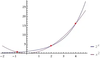

How many real roots are there to $2^x=x^2$?

In summary, there are three real solutions: one lies in $(-1,0)$, the second is $2$, and the third is $4$.

By drawing the graphs of both functions, we can easily guess that there are three. What the roots actually are, I don't know, but at least I can answer your question.
To prove this, one might want to use Rolle's Theorem on the function $f(x) = 2^x - x^2$ to show the existence of the third $0$, which is the non-trivial one (the first two are $x=2$ and $x=4$). Just notice that $f(0) = 1$ and say $f(-100) < 0$, hence there exists a zero between those points. Since the derivative of $f$ is strictly positive in the interval $(-\infty, 0)$, this is the only one in this interval.
