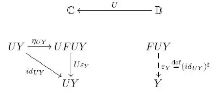

Remember that, by definition of universality, for every $A\in\mathbf{C}$ there is some $F_{A}\in\mathbf{C}$ and some $\eta _{A}:A\to UF_{A}=UFA$ such that for any $f: A\to UY$, there exists a unique $f^{\sharp}:FA\to Y$ such that $f=Uf^{\sharp}\circ\eta_{A}$. The proof of part (1) gives us that for any $h:A\to B$ there exists a unique $Fh:= (\eta_{B}\circ h)^{\sharp}: FA\to FB$.
For any $Y\in\mathbf{D}$, universality then gives us a unique $\varepsilon_{Y}:=(id_{UY})^{\sharp}: FUY\to Y$ such that $id_{UY}=U\varepsilon_{Y}\circ\eta_{UY}$. [Think of putting $A=UY$ for just for a moment.]

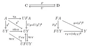

In order to show that $\varepsilon_{Y}$ is a universal arrow from $F$ to $Y$, we need to show that for any $g:FA\to Y$, there exists a unique $g^{\flat }:A\to UY$ such that $g=\varepsilon_{Y}\circ Fg^{\flat }$.
For any such $g$ define $$g^{\flat}:=A\stackrel{\eta_{A}}{\longrightarrow}UFA\stackrel{Ug}{\longrightarrow}UY$$.
I've proven that, indeed, $$g=(g^{\flat})^{\sharp}$$ but I don't understand why $$(g^{\flat})^{\sharp}=\varepsilon_{Y}\circ Fg^{\flat}$$ follows from the naturality of $\eta$.
I think I'm nearly there with this overworked diagram
but I just don't see it yet. I can't prove it to myself. Please help. Is there something really subtle yet easy I've missed?

Actually the proof follows from a combo of naturality of the $\eta_A$'s and their universal property.
From naturality we get the commutativity of the following diagram $$\require{AMScd}\begin{CD}A @>\eta_A>> UF(A) \\ @V{g^\flat}VV @V{UF(g^\flat)}VV\\ U(Y) @>{\eta_{U(Y)}}>> UFU(Y)\end{CD}$$ and composing on the left with $U(\epsilon_Y)$ we get that $$g^\flat = U(\epsilon_Y)\circ \eta_{U(Y)} \circ g^\flat = U(\epsilon_Y \circ F(g^\flat))\circ \eta_A$$ where the first equality follows the construction of $\epsilon_Y$.
From this equality we end up with the commutative square $$\begin{CD}A @>\eta_A>> UF(A) \\ @V\eta_AVV @VVU(\epsilon_Y \circ F(g^\flat))V \\ UF(A) @>U(g)>> U(Y)\end{CD}$$ and the from the universal property of $\eta_A$ it follows that $g=\epsilon_Y \circ F(g^\flat)$.
Since $g=(g^\flat)^\sharp$ it follows that $(g^\flat)^\sharp = \epsilon_Y \circ F(g^\flat)$.
