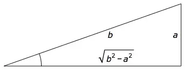

To solve a problem like $\tan(\sin^{-1}(a/b))$, one can first set up a right triangle for $\sin^{-1}(a/b)$ by letting the hypotenuse be $b$ and the altitude be $a$. (If $a/b$ is negative, put the negative sign with $a$.) Then solve for the base, $\sqrt{b^2-a^2}$. The tangent is the altitude divided by the base, or $a / \sqrt{b^2-a^2}$.
Mathematica graphics
