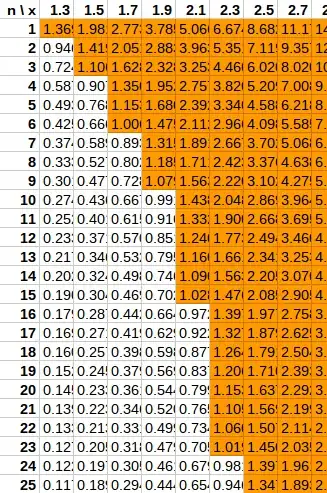

So, $$ (1+x/n)^n = e^x \exp\left(-\frac{x^2}{2n} \frac{1}{(1+\xi)^2}\right) \tag{2}$$ which is already a reasonable error estimate. When $x>0$, it can be brought into the form you seek without too much sweat. Since $\xi>0$ in (2), we have $$ 0<e^x-(1+x/n)^n < e^x(1-e^{-x^2/(2n)}) \tag{3}$$ Use the Mean Value theorem (i.e., the simplest form of the Lagrange remainder formula): $$ 1-e^{-x^2/(2n)} = \frac{x^2}{2n} e^{-\zeta},\quad 0<\zeta<\frac{x^2}{2n} \tag{4}$$ Hence, the conclusion: for $x>0$, $$ 0<e^x-(1+x/n)^n < \frac{x^2}{2n}e^x \tag{5}$$ Of course, (5) is not telling us anything new when $x^2>2n$. But it correctly shows that $x^2/n$ is what determines the quality of approximation. This quadratic relation is visible on the spreadsheet below, where I calculated the difference $e^x-(1+x/n)^n$ and colored the cells where the difference is at least $1$.
spreadsheet
