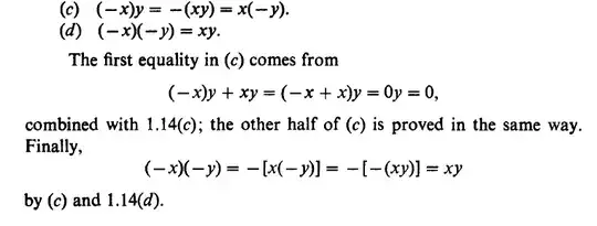

Principles of Mathematical Analysis - Walter Rudin, 3rd Ed, p7:
  • Regarding the last equality, -(-(xy))=xy, here is the proof: By addition inverses axiom, -x+x=0. Replace x by -x. This gives -(-(x))=x – Franck Dernoncourt Oct 25 '13 at 15:18
  • By the way you will still have to prove $0 \cdot y = 0$, this shouldn't be difficult though. – Arthur Oct 25 '13 at 15:24
  • Also still need to prove that ax+b=0 has one and only solution but I know how to prove these two, so that's really good enough for me. – MCL Oct 25 '13 at 15:28
