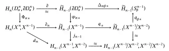

The left vertical arrow in the upper diagram is, up to the isomorphism described in the lower diagram, the inclusion of a direct $\Bbb Z$-summand into the direct sum. Composing this inclusion with $d_n$ and subsequently with the map to $\tilde H_{n-1}(S^{n-1}_\beta)$, which algebraically is the projection onto the direct summand for $\beta$, we get the composition $\Delta_{\alpha\beta*}\partial$. If we change the homeomorphism $h_β:D_β/∂D_β\to S_β$, so that the "typical" generator of $H_{n-1}(D_β,∂D_β)$ gets now mapped to the negated "typical" generator of $H_{n-1}(S_β)$, then each $e_β$ among the images of the cells under $d_n$ is replaced by $-e_β$. However, each $e_β$ among the generators of the kernel of $d_{n-1}$ would also have to be replaced by $-e_β$ since the value $d_{n-1}(e_β)$ has been negated by changing the homeomorphism. So overall nothing would change.
