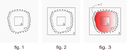

Update. As my previous figure had conceptual mistakes I decided to change the picture to another, more instructive

I reproduce below the statement of the lemma and its proof together as some figures to illustrate what I did the first half of the demonstration of the lemma.

Proof. Suppose that $\mu(E^+)=0$. Then any given square $\Delta$ is almost surely surrounded by a $-*$circuit, and with probability close to $1$ such a circuit can already be found within a square $\Lambda\supset\Delta$ provided $\Lambda$ is large enough. If this occurs, we let $\Gamma$ be the largest random subset of $\Lambda$ which is the interior of such a $-*$circuit. (A largest such set exists because the union of such sets is again the interior of a $-*$circuit.) In the alternative case we set $\Gamma=\emptyset$. By maximality, $\Gamma$ is determined from outside [ see figure below].
