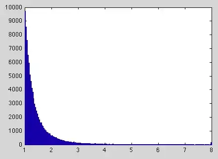

Thank you to Chris for the prompt answer which works perfectly! So for $\alpha = 3$ and $x_{\mathrm{min}} = 1$, when I choose 100,000 random values of u in [0,1] I get this distribution of values of $F^{-1}(u) = x_{\mathrm{min}} (1-u)^{-1/\alpha}$:
Histogram
... which is just what I'm after (there's a little blip at the end for truncated values of $x>8$).
In fact, since u is evenly distributed I can get exactly the same distribution using $F^{-1}(u) = u^{-1/\alpha}$ which is shorter.
