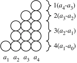

Suppose we want to count the number of non-decreasing sequences of $n$ non-negative integers which sum to $m$. That is, $a_{k+1}\ge a_k$ and $$ \sum_{k=1}^na_k=m\tag{1} $$ Note that if we set $a_0=0$, then $$ \begin{align} m &=\sum_{k=1}^na_k\\ &=\sum_{k=1}^n\sum_{j=1}^k(a_j-a_{j-1})\\ &=\sum_{j=1}^n\sum_{k=j}^n(a_j-a_{j-1})\\ &=\sum_{j=1}^n(n-j+1)(a_j-a_{j-1})\tag{2} \end{align} $$ The following diagram illustrates $(2)$ for $n=4$:
$\hspace{4.5cm}$enter image description here
Consider the product $$ \overbrace{(1+x^n+x^{2n}+\dots)}^{\large x^{(a_1-a_0)n}} \overbrace{(1+x^{n-1}+x^{2(n-1)}+\dots)}^{\large x^{(a_2-a_1)(n-1)}} \dots\overbrace{(1+x+x^2+\dots)}^{\large x^{a_n-a_{n-1}}}\tag{3} $$ In the first factor, we choose $x^{(a_1-a_0)n}$. In the second factor, we choose $x^{(a_2-a_1)(n-1)}$. In the $k^\text{th}$ factor, we choose $x^{(a_k-a_{k-1})(n-k+1)}$. In the product, the coefficient of $x^m$ is the number of ways to make the sum in $(2)$.
The product in $(3)$ can be rewritten as $$ \prod_{k=1}^n\frac1{1-x^k}\tag{4} $$ The coefficient of $x^m$ in $(4)$ is the number of non-decreasing sequences of $n$ non-negative integers which sum to $m$.
