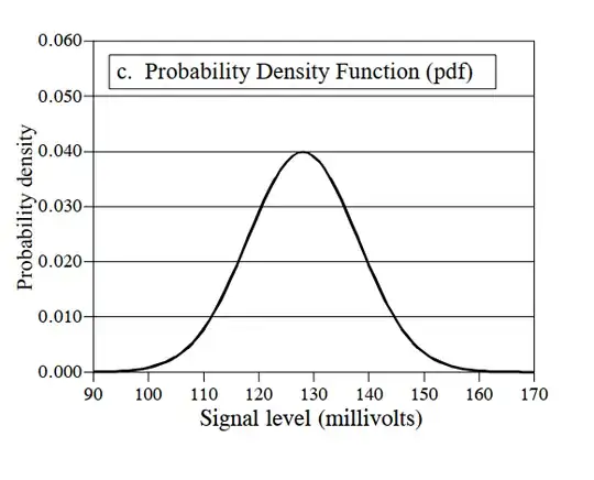

There is an excellent explanation about this in the chapter 2 of the book The Scientist and Engineer's Guide to Digital Signal Processing.pdf.
Quoting from the book -
The probability density function (pdf), also called the probability distribution function, is to continuous signals what the probability mass function is to discrete signals.
The vertical axis of the pdf is in units of probability density, rather than just probability. For example, a pdf of 0.03 at 120.5 does not mean that the a voltage of 120.5 millivolts will occur 3% of the time. In fact, the probability of the continuous signal being exactly 120.5 millivolts is infinitesimally small. This is because there are an infinite number of possible values that the signal needs to divide its time between: 120.49997, 120.49998, 120.49999, etc. The chance that the signal happens to be exactly 120.50000 is very remote indeed!
To calculate a probability, the probability density is multiplied by a range of values. For example, the probability that the signal, at any given instant, will be between the values of 120 and 121 is: (121 - 120) × 0.03 = 0.03. The probability that the signal will be between 120.4 and 120.5 is: (120.5 - 120.4) × 0.03 = 0.003 , etc. If the pdf is not constant over the range of interest, the multiplication becomes the integral of the pdf over that range. In other words, the area under the pdf bounded by the specified values.
