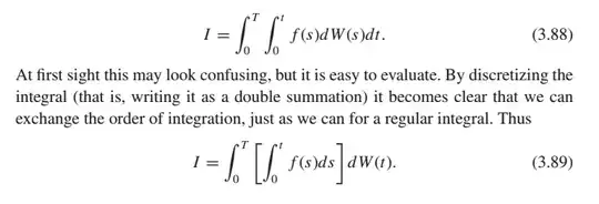

Stochastic Processes for Physicists by Jacobs says that we can exchange the order of a multiple Ito stochastic integral, giving the example:
I don't see how this works either for a regular integral or a stochastic integral.
For a regular integral, suppose I let $f=1$ and $W(s) = s^2$ so $dW(s) = 2s ds$. I'm getting that (3.88) evaluates to $T^3/3$ while (3.89) evaluates to $2T^3/3$. Am I missing something?
For a stochastic Ito integral, if $f=1$ and $dW(s)$ is Gaussian, then (3.89) simplifies to
$$I = \int_0^T t dW(t)$$
which gives a Gaussian with zero mean and variance $T^3/3$.
I don't completely understand the meaning of (3.88) in this context. Does it also imply that $I$ is Gaussian with a variance $T^3/3$?
What are the missing steps implied in "discretizing the integral"? (I tried writing this out, but didn't find something that was obviously the same sum.)
  • How can $dW_s = 2s , ds$? By definition $dW_s \equiv W_{s+ds} - W_s$. – wsw Oct 10 '13 at 15:39
  • $(s+ds)^2 - s^2 = 2s ds + ds^2 = 2s ds$ – Mark Eichenlaub Oct 10 '13 at 15:44
  • Mark: $dW_s \sim \mathcal{N}(0, ds)$ is a random variable, while $ds$ is a deterministic quantity. For example, $\text{Var}(ds) = 0$. – wsw Oct 10 '13 at 15:57
  • Mark: I think I know what the problem is. You simply cannot say $W_s = s^2$ since $W_s$ is Brownian motion. – wsw Oct 10 '13 at 17:59
    In the portion where I set W=s^2, I am not talking about stochastic integrals, but instead just a regular integral, so your criticisms do not make sense. – Mark Eichenlaub Oct 10 '13 at 22:02
Mark: I got it -- there's a typo in the book. Note that the integration region is triangular. In other words, $$ \int_0^T \left( \int_0^t g_{s,t} \, dy_s \right) dt = \int_0^T \left( \int_s^T g_{s,t} \, dt \right) dy_s \, . $$
Let's use your example of $y = s^2$, where $dy = 2s \, ds$.
$$ \int_0^T \int_0^t 2s \, ds \, dt = \int_0^T t^2 \, dt = \frac{T^3}{3}. $$
For the other way, $$ \int_0^T \int_s^T dt \, 2s \, ds = \int_0^T (T-s) 2s \, ds = T^3 - \frac{2}{3}T^3 = \frac{T^3}{3}. $$
