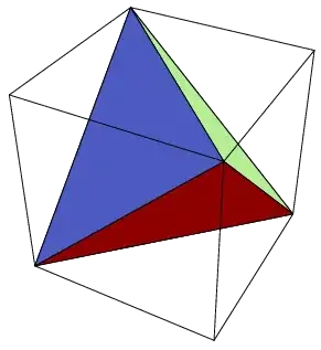

One idea is to view $S_n$ as permutations of pairs in a $2n$-element set. (This approach may be equivalent to Omar's answer above, but it's more elementary.)
Let $X = \{x_1,\ldots,x_n\}$ be an $n$-element set. We can define a $2n$-element, call it $\pm X$, by adding a formal "opposite" to each element of $X$, so $\pm X = \{x_1,-x_1,\ldots,x_n,-x_n\}$.
We can define a map $\operatorname{Perm}(X) \to \operatorname{Perm}(\pm X)$, sending $\sigma \mapsto (\operatorname{sgn}\sigma)\cdot \sigma$. That is, if $\sigma$ is odd, it acts on $\pm X$ like it would on $X$, but also flips signs. If $\sigma$ is even, it does the permutation $\sigma$ on positive and negative elements independently.
$S_n$ acts on the $n$ subsets $\{\pm x_i\}$, sending $\{\pm x_i\} \mapsto \{\pm \sigma(x_i)\}$. The subgroup $A_n$ inherits the same action, but it preserves the two subsets $+X$ and $-X$ of $\pm X$ containing the positive and negative elements.
For a geometric example, see the 4 vertices of the tetrahedron below. If this figure is centered at the origin, then the opposites of the vertices complete a cube. The octahedral group $O$ is isomorphic to $S_4$, permuting the diagonals of this cube. Some rotations of the cube, corresponding to odd permutations in $S_4$ send this tetrahedron to the one consisting of the other four vertices. Only the even permutations, $A_4$, preserve the tetrahedron.
          CubeTetra
(Image from MathWorld.)
