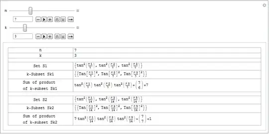

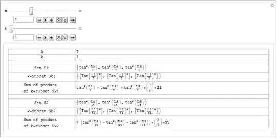

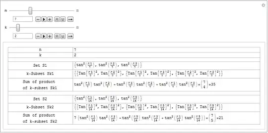

Here are some examples with n=7 and k varying from 1 to 3. We have: $S=\left\{\tan ^2\left(\frac{\pi 1}{7}\right),\tan ^2\left(\frac{\pi 2}{7}\right),\tan ^2\left(\frac{\pi 3}{7}\right)\right\}$
  1. for k=1, k-subset is $S_1=\left\{ \left\{\tan ^2\left(\frac{\pi 1}{7}\right)\right\},\left\{\tan ^2\left(\frac{\pi 2}{7}\right)\right\},\left\{\tan ^2\left(\frac{\pi 3}{7}\right)\right\} \right\}$, so $\tan ^2\left(\frac{\pi 1}{7}\right)+\tan ^2\left(\frac{\pi 2}{7}\right)+\tan ^2\left(\frac{\pi 3}{7}\right)=\left( \begin{array}{c} 7 \\ 2 \end{array} \right)=21$
  2. for k=2, k-subset is $S_2=\left\{ \left\{\tan ^2\left(\frac{\pi 1}{7}\right),\tan ^2\left(\frac{\pi 2}{7}\right)\right\},\left\{\tan ^2\left(\frac{\pi 2}{7}\right),t\tan ^2\left(\frac{\pi 3}{7}\right)\right\},\left\{\tan ^2\left(\frac{\pi 1}{7}\right),t\tan ^2\left(\frac{\pi 3}{7}\right)\right\} \right\}$, so $\tan ^2\left(\frac{\pi 1}{7}\right) \tan ^2\left(\frac{\pi 2}{7}\right)+\tan ^2\left(\frac{\pi 3}{7}\right) \tan ^2\left(\frac{\pi 2}{7}\right)+\tan ^2\left(\frac{\pi 1}{7}\right) \tan ^2\left(\frac{\pi 3}{7}\right)=\left( \begin{array}{c} 7 \\ 4 \end{array} \right)=35$
  3. for k=3, k-subset is $S_3=\left\{ \left\{\tan ^2\left(\frac{\pi 1}{7}\right),\tan ^2\left(\frac{\pi 2}{7}\right),\tan ^2\left(\frac{\pi 3}{7}\right)\right\} \right\}$, so $\tan ^2\left(\frac{\pi 1}{7}\right) \tan ^2\left(\frac{\pi 2}{7}\right) \tan ^2\left(\frac{\pi 3}{7}\right)=\left( \begin{array}{c} 7 \\ 6 \end{array} \right)=7$
Tan binomial formulaes 1 Tan binomial formulaes 2 Tan binomial formulaes 3
Here is the Mathematica code corresponding to the images, if someone wants to play around:
