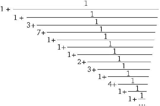

Continued fraction form of the problem up to n=14
I wanted to add the continued fraction format of the problem. This post is not really intended to be an answer
Logarithm
  • 395
    How do you know that this continued fraction corresponds to the problem? – chubakueno Oct 06 '13 at 02:40
    Any symbolic computation software will do the job. I did it with Mathematica – Logarithm Oct 07 '13 at 23:30
  • I know that if I approximate it well enough, I can procedurally do this. But I was more about asking about the pattern (i see nothing). However, if you are interested in programming, this is always a good exercise.(Ask GNU MP if you have precision issues :)) – chubakueno Oct 08 '13 at 01:27
