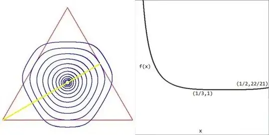

enter image description here       enter image description here       enter image description here

The insides and outsides of both can easily be visualized, as has been done in the above picture on the right (seen in the plane of the triangle, with a transformation rectangular $(x,y) \rightarrow$ equilateral) :
$\color{red}{red}$ for the edges of $\;a + b + c = 3\;$ and $\color{green}{green}$ for $\;\frac{2}{(a+b)(4-ab)}+\frac{2}{(b+c)(4-bc)}+\frac{2}{(a+c)(4-ac)} < 1\;$ and simply white for $\;\frac{2}{(a+b)(4-ab)}+\frac{2}{(b+c)(4-bc)}+\frac{2}{(a+c)(4-ac)} > 1\;$ . (With a smooth function - this one is not - the isolines would look a lot "neater".)
It is seen in the same picture that the vertices of the triangle could well have been put on the curve $\frac{2}{(a+b)(4-ab)}+\frac{2}{(b+c)(4-bc)}+\frac{2}{(a+c)(4-ac)} = 1$ . However, this would require that $x=0$ and/or $y=0$ , which is excluded by $\;b=3x,c=3y$ both $> 0$ . For the rest the triangle is seen to be on the outside of that curve , i.e. in the white area, thus establishing, at first sight, the given inequality.

There is not a whole bunch of points inside the triangle where $f(a,b,c) = 1$, because otherwise we would have seen them as green pixels. But the fact that they are not seen is not a proof that they do not exist. So we still have to establish, analytically, that $f(a,b,c)$ assumes no smaller values than $1$ inside the triangle.

Update. As a reply to the comments about whether there could perhaps exist a minimum at a lower level than $1$ , here comes a contour plot of $\;f(a,b,c)\;$ values in the plane of the triangle at levels $\; 1 < (2^k*10+2)/(2^k*10+1) \quad , \quad k=0 , \cdots , 11$ .
Showing a rather "flat" function behaviour, though definitely descending towards the middle of the triangle : the perimeters of the contours are invariably diminishing with increasing values of $\;k\;$.
Let's specify $f(a,b,c)$ for $y=x\;$ i.e. $\;a=3(1-2x) , b=3x , c=3x$ . This is the yellow line in the contour plot on the left. Then we have: $$ f(x) := f(3(1-2x),3x,3x) = \frac{4}{3(1-x)(4-9x+18x^2)}+\frac{1}{3x(4-9x^2)} $$ The graph of this function is seen on the right. As expected, there is a positive singularity at $x=0$ . Then the function decreases uniformly until it reaches its minimum $f(1/3)=1$ at the center of the triangle. After that it raises a little bit until that local maximum $f(1/2)=22/21$ in the middle of an edge. That $f(1/3)=1$ is indeed a minimum can be verified by calculating $f'(1/3) = 0$ .
